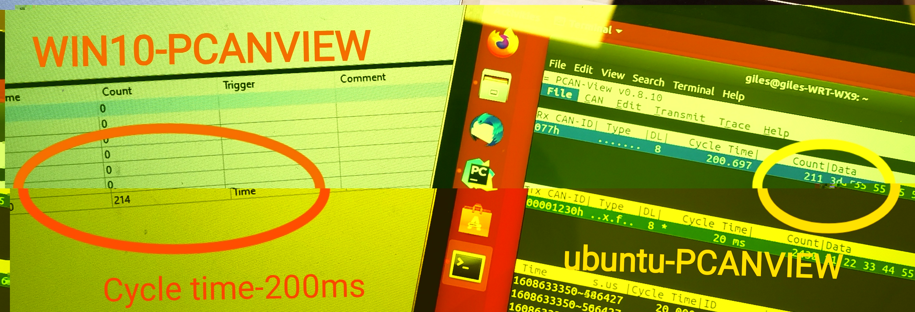

I try to read CAN msgs and then transmit the processed CAN msgs via PEAK CAN-USB in Python (with the Py) environment, while I found there is a heavy latency communication between PCAN-View and Python environment as shown in below pictures.
I simulate the signals from WIN10 PCAN-View and you can see the count number in ubuntu is less than the number in WIN10 PCAN-View
and the same situation we can found the Data is also different at the same time
I also tried in ubuntu PCAN-View transmit to ubuntu Python, also occurred the above situation.

i noticed you use the return of "PCAN_ERROR_OK" as your condition for the read loop, which might leads to
the behaviour you have seen, as you will break the condition as soon as something else is returned, wether or not the queue
is actually empty at this point.
The ideal implementation is shown in the PCANBasic Python example,
which is exactly the reverse order:
The function read messages will either call "ReadMessageFD" or "ReadMessage" (Depending on the messagetype) as
long as "PCAN_ERROR_QRCVEMPTY" is not returned.
Look for the function "ReadMessages" in the Python example of the PCANBasic Package:
  def ReadMessages(self):
        stsResult = PCAN_ERROR_OK
        # We read at least one time the queue looking for messages.
        # If a message is found, we look again trying to find more.
        # If the queue is empty or an error occurr, we get out from
        # the dowhile statement.
        while (self.m_CanRead and not (stsResult & PCAN_ERROR_QRCVEMPTY)):
            stsResult = self.ReadMessageFD() if self.m_IsFD else self.ReadMessage()
            if stsResult == PCAN_ERROR_ILLOPERATION:
                break
The called functions will check for "PCAN_ERROR_OK" and will only
process the message if it is returned (Processing could be printing the message, for example):
def ReadMessage(self):
        # We execute the "Read" function of the PCANBasic
        result = self.m_objPCANBasic.Read(self.m_PcanHandle)
        if result[0] == PCAN_ERROR_OK:
            # We show the received message
            self.ProcessMessage(result[1:])
        return result[0]
The "ReadMessages"-function itself is called by either on timer-tick,with a receive event or manually on call.
In your case you might want to implement a timer based version of the read,
please see the provided example for Python in the PCANBasic-Package to see how this can be implemented.
Please let us know, if this was helpful to you.
Best Regards
Marvin

Dear Sir,
Thanks very much for your swift response, and the main reason maybe out of I invoke the Read function twice, so lead the data update in buffer, now I update the code as below, all issues are killed now.
Besides, do we have the .dbc file decode file example for python or cpp which can realize the data decoding in real-time from CAN bus with the .dbc file application?
Thanks very much and have a nice day and happy new year.
    while (True):
#        stsSystem = objPCAN.Read(channel)[0]
        RecMsg = objPCAN.Read(channel)
        sysStatus = RecMsg[0]
        RecData = RecMsg[1]
        #if RecMsg.ID != 0:
        if sysStatus != PCAN_ERROR_QRCVEMPTY:
            print(list(RecData.DATA))
            i = i + 1
            print(i)
            break
