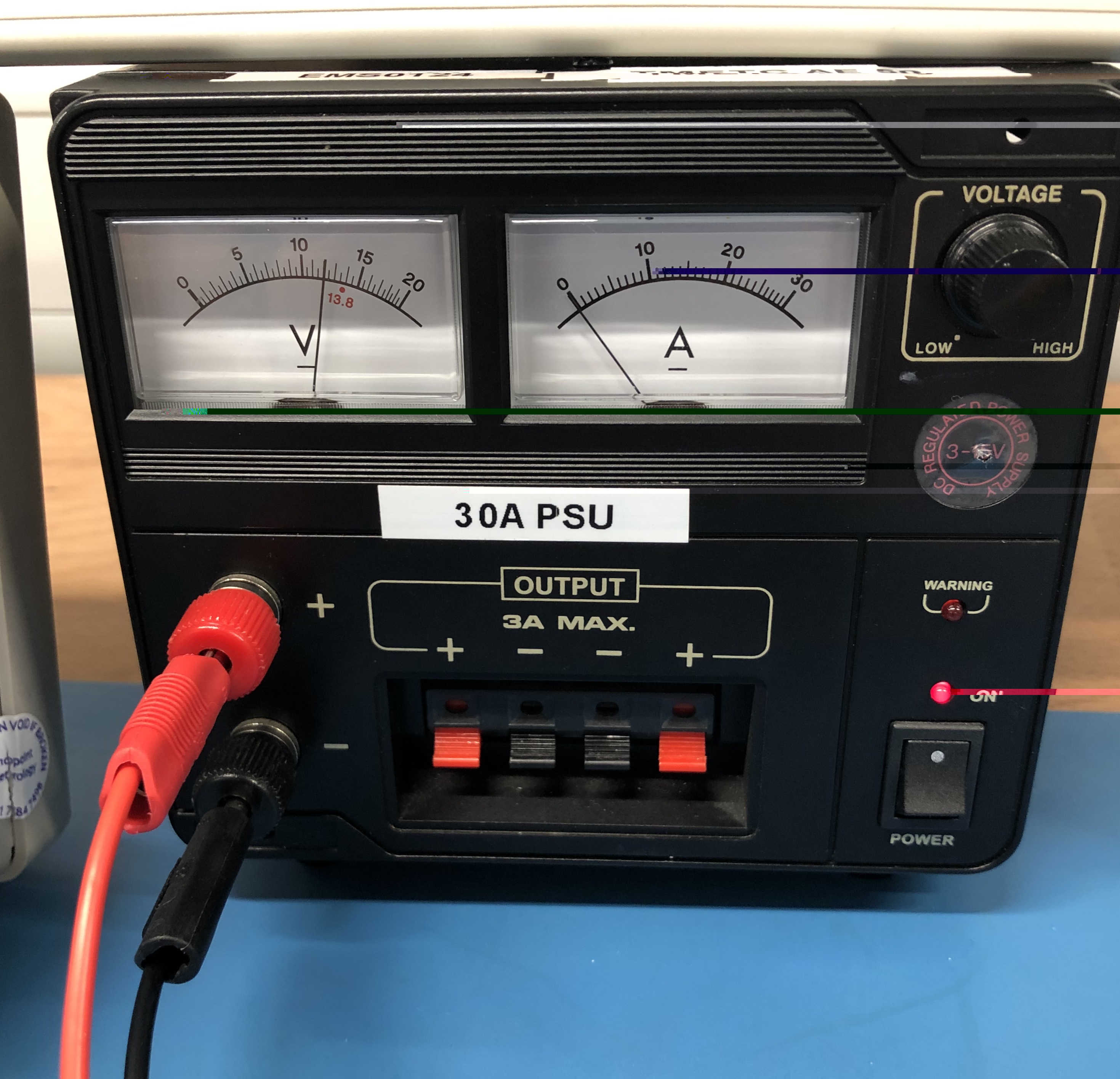

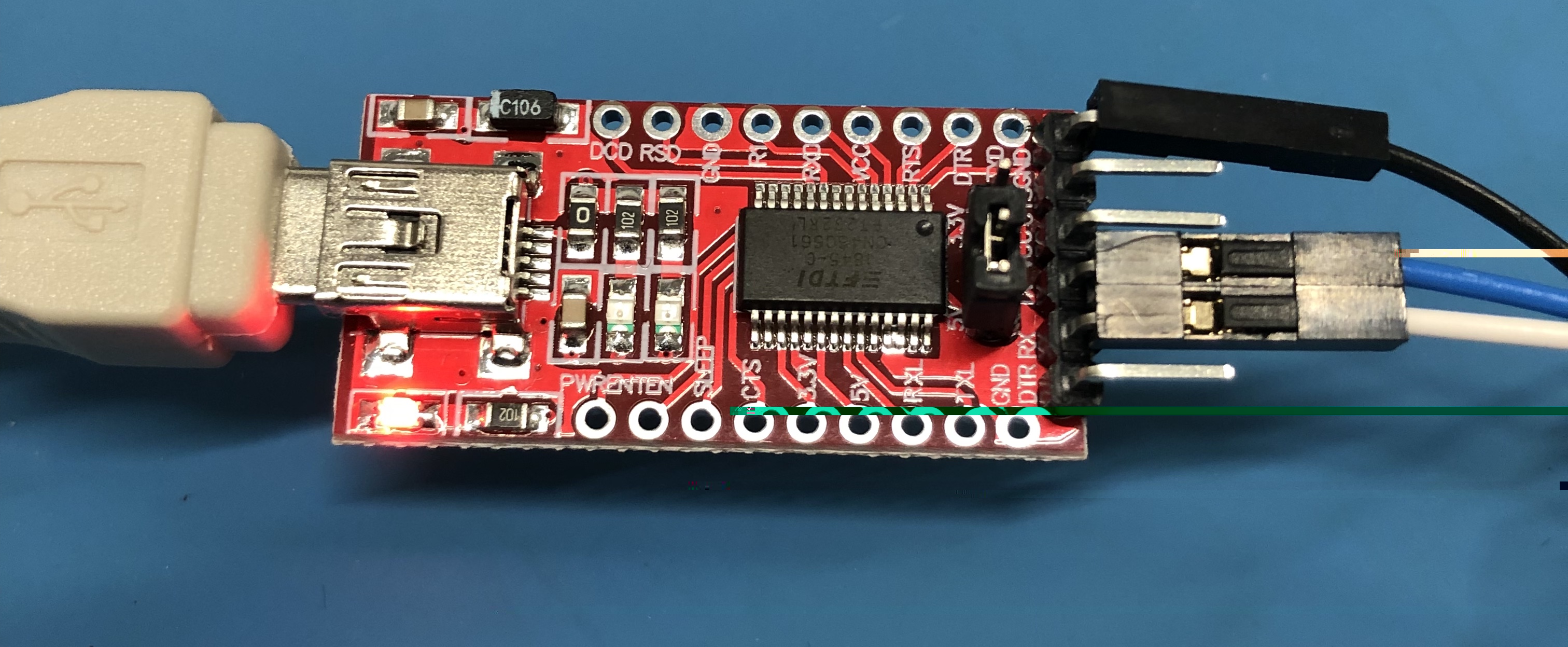

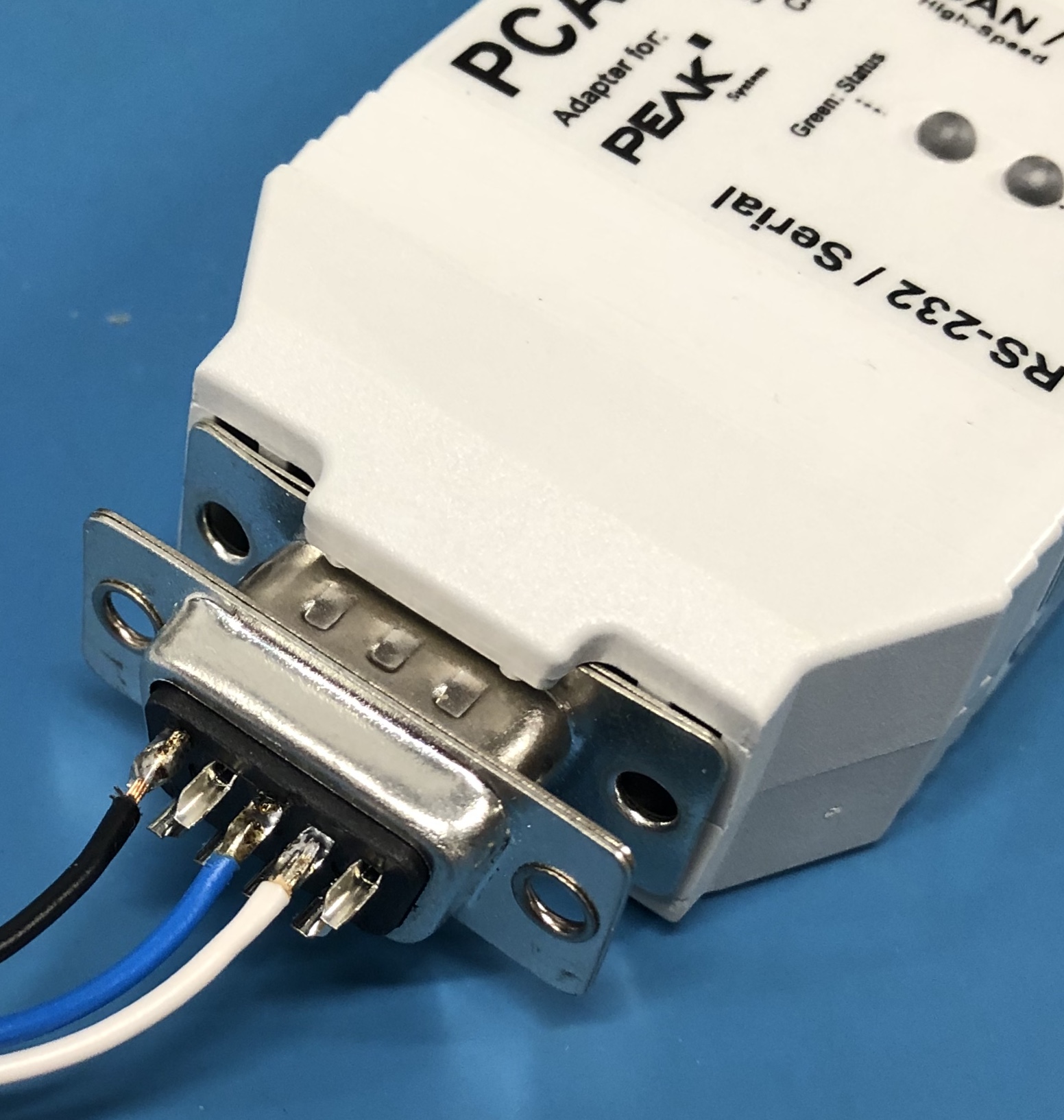

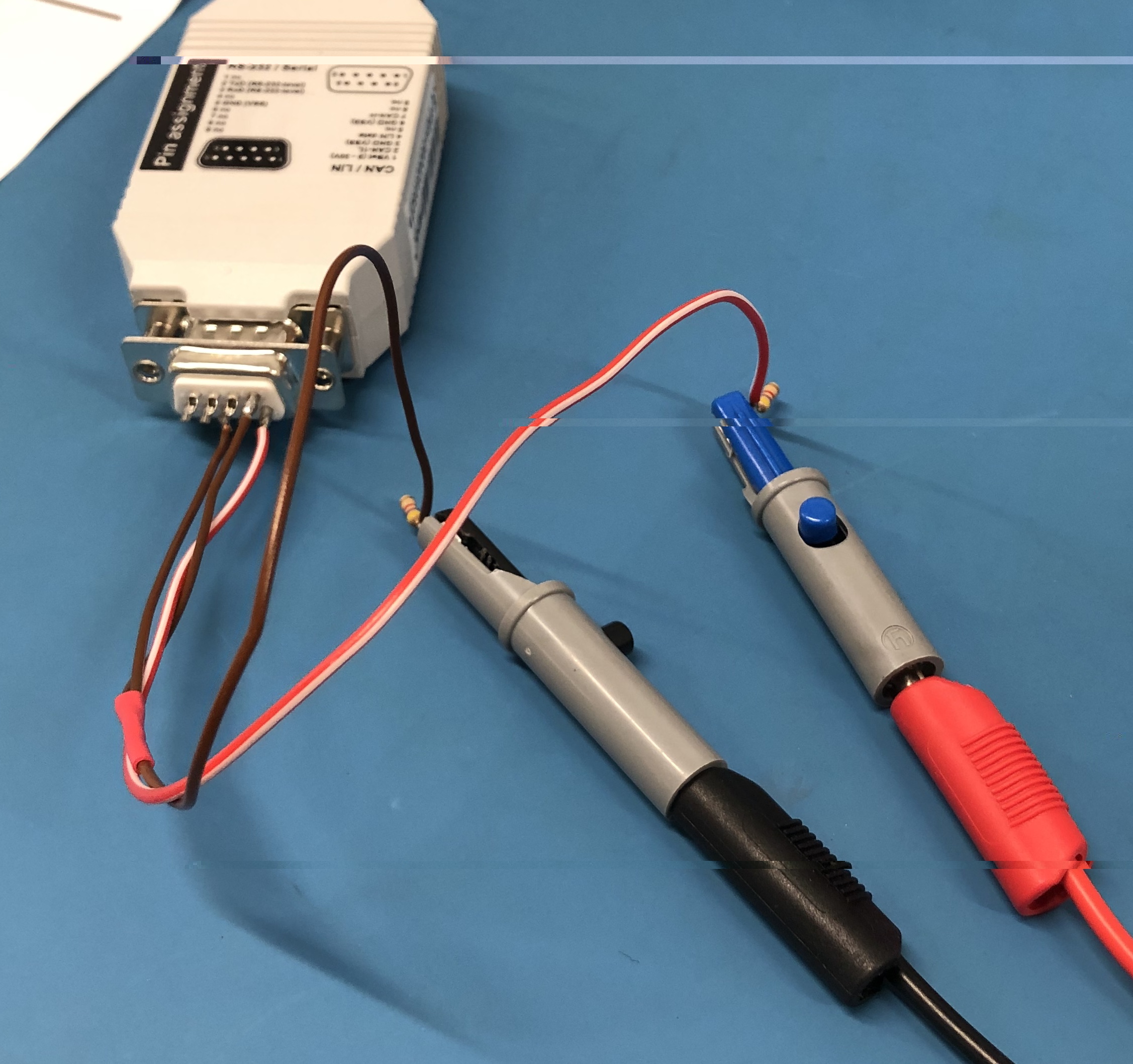

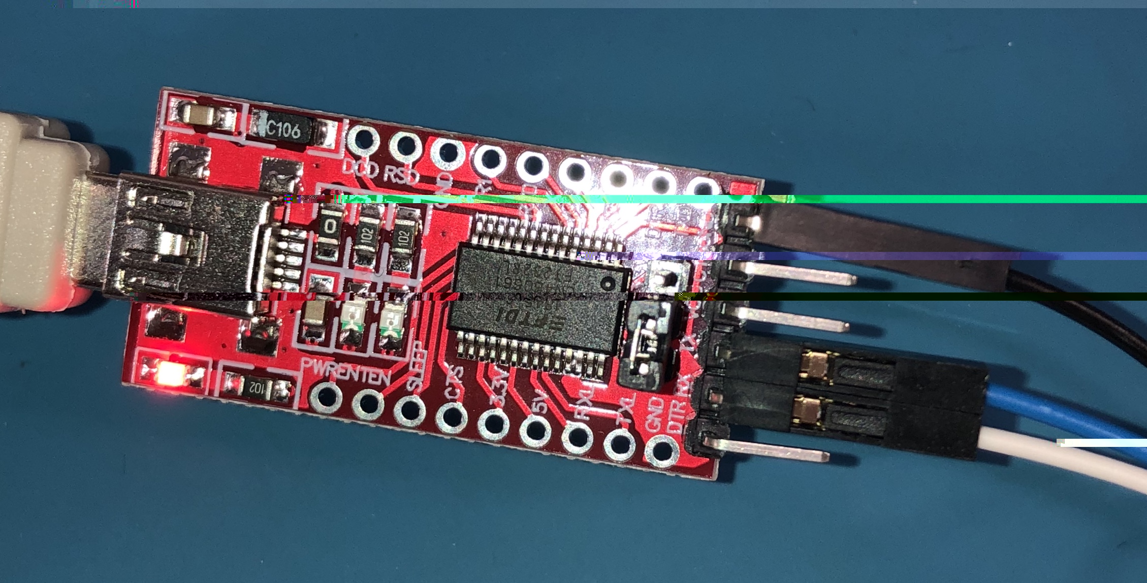

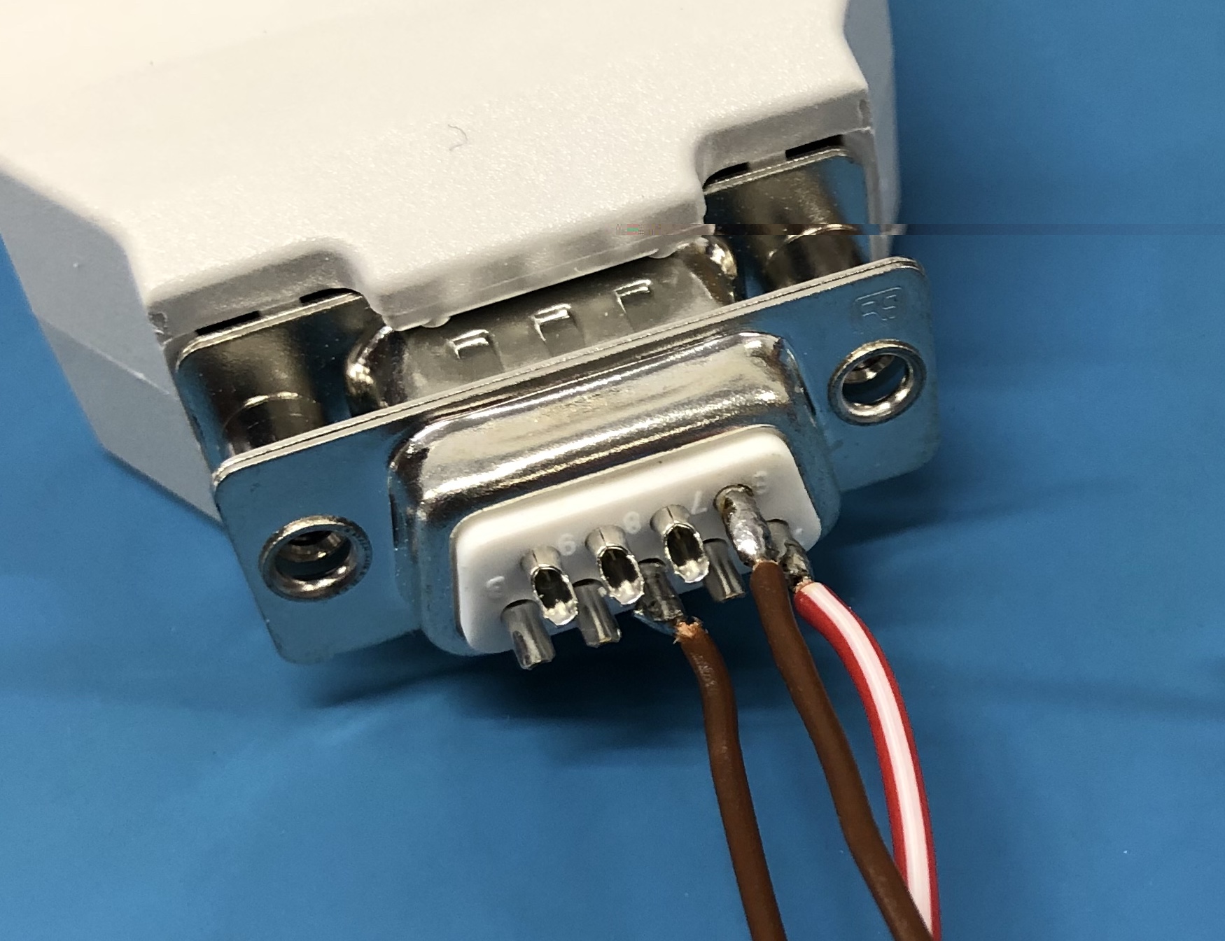

Still struggling..........
I have the config file that was previously used on this interface .... image of it loaded attached
So we now know speed is factually at 38400 but still unable to connect with a simple USB/RS232 interface, it is an FTDI, tried both inverted and non-inverted RX,TX signals.
In despair I purchased a new unit, ser. no. 05271
This is no better, tried both 38400 and 115200.
I must be doing something stupid, attached are images of my setup.
Please can you review for me?
Thank you
Steve
