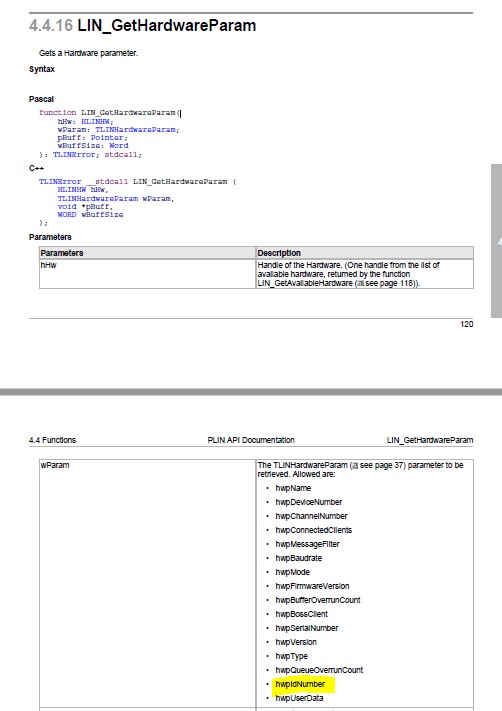

I'm currently implementing the update of the HardwareID with the API but the ID is not really updating.
When I execute the SetHardwareParam everything goes fine, but when I read it back the value doesn't update (I've confirmed with PLIN-View PRO).
Any ideas?

Yes it works fine, if I set the ID with PLIN-View PRO, I can read it back in my app.
I found out the problem, I was setting wBuffSize to 0 as you can see in the picture of my last post. Now that I understand the purpose of such parameter it's weird that the method accepts it to be 0 without "complaining".

It is a global function that call different subfunction depending on the Parameter (which make it flexible for new features without changing the API)
So a validation is nearl impossible, because there exist parameters where a zero is OK.
