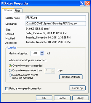

after several tests and researches we were able to find the reason for this issue (LIN Manager + .Net on computers with Windows XP) :!: The problem lies on events registration done using the .Net component EventLog.
The PLIN Manager, trhough the component mentioned before, was creating a custom log for event logging corresponding to the LIN environment. This log was created at install time as a "circular" log which a size of 1MB, which means that at the moment the log becomes full, it starts to delete older entries to write the new ones again.
The event registration with EventLog propertly work on Windows Vista, and Seven; but it seems to fail on computers using XP with certain user rights configurations, so that the log file behaves itself different than configured, when it becomes full. The workaround installing .Net again worked for some machines because the .Net re-installation changed also some parameters for the EventLog functionality, but some other times even this was not a help.
To avoid this problem in the future, we will take the Event-Logging part out of the service :) but until the new version is released, here is a new workaround for the problem:
  1. Go to the Control pannel and search for "Administrative Tools"
  2. In Administrative tools, start the Event Viewer tool
  3. Look for the entry PEAKLog (left side list) and open its properties.
  4. Clear the log (by clicking the buttont "Clear Log") and be sure the configuration is as follow:
    PEAKLog Configuration
We want to emphasize that this problem only occurs on Windows XP computers that have certain user rights.
Even when this issue is not directly our fault, we want to apologise for the inconvenients caused :roll: and to thank you for your patience.
