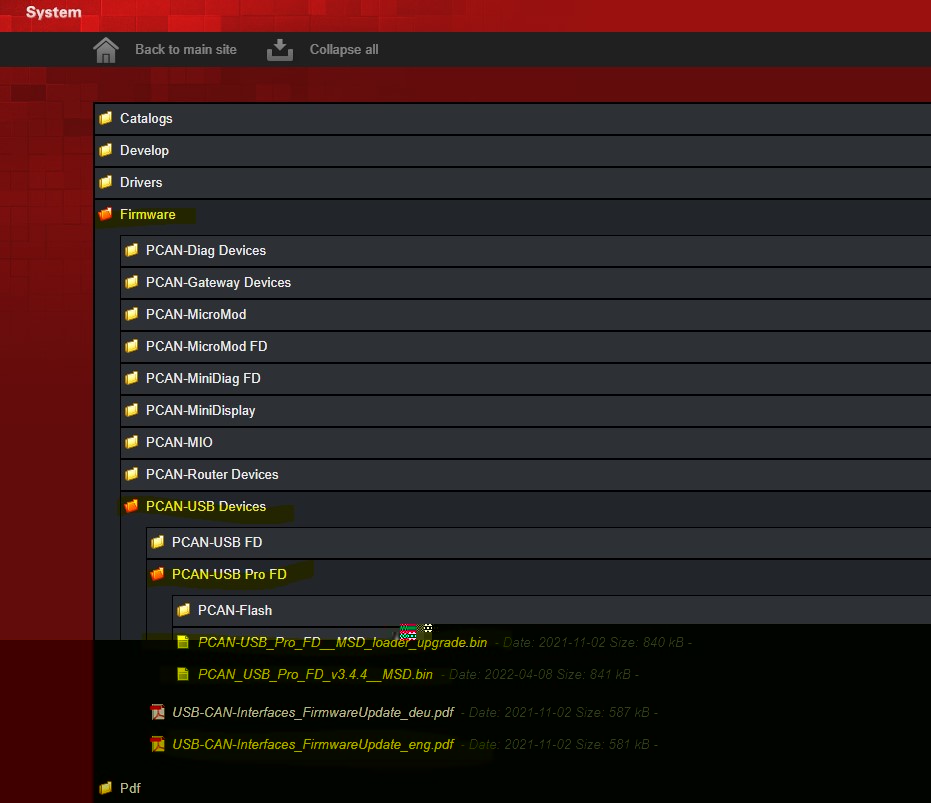

If you own a first Generation PCAN-USB Pro FD and like to use the latest Firmware 3.x, you need to be sure that you bring your system up to date with some special Tools.
Since Firmware 3.x we have add a new Bootloader and you could update your PCAN-USB Pro FD very simple with our PEAK-Flash Tool --> link. This Tool includes always the latest Firmware vor nearly all PEAK-System CAN/LIN Devices.
If you own a PCAN-USB Pro FD with a Firmware 1.x or 2.x please follow this Steps:
Download the needed Bootloader Firmware and Documentation how to flash older Devices with the new Bootloader from this link.
or check this page: https://www.peak-system.com/produktcd/
Please read the Documentation and follow the steps as explained.
To flash the MSD-Bootloader to the Device, you need to use a Windows 8.1 or Windows 7 System :!:
W10 / W11 is not supported by this old Tools.
When your PCAN-USB Pro FD have once a Firmware >=3.x, you could use the PEAK-Flash Tool to bring it very simple up to date
