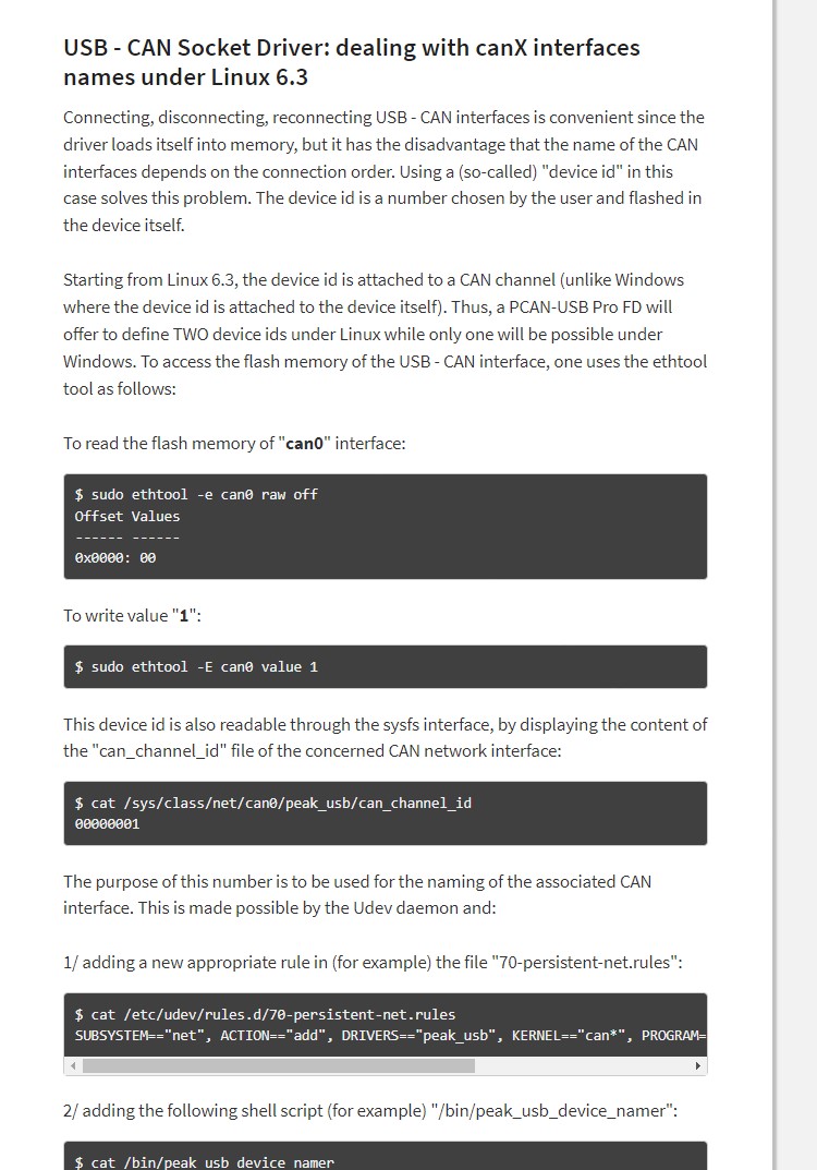

if you are using the kernel integrated netdev driver (SocketCAN) and you use a kernel 6.3 or higher then you can fix the canX names via the following instructions :
https://www.peak-system.com/fileadmin/m ... /index.htm

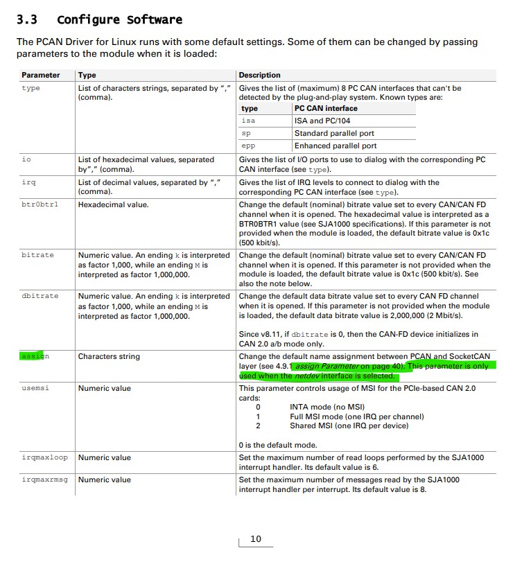

If you use our proprietary netdev driver then you must use the assign parameter, for more infos please take a look into the PCAN_Linux driver manual:
https://www.peak-system.com/fileadmin/m ... an_eng.pdf
