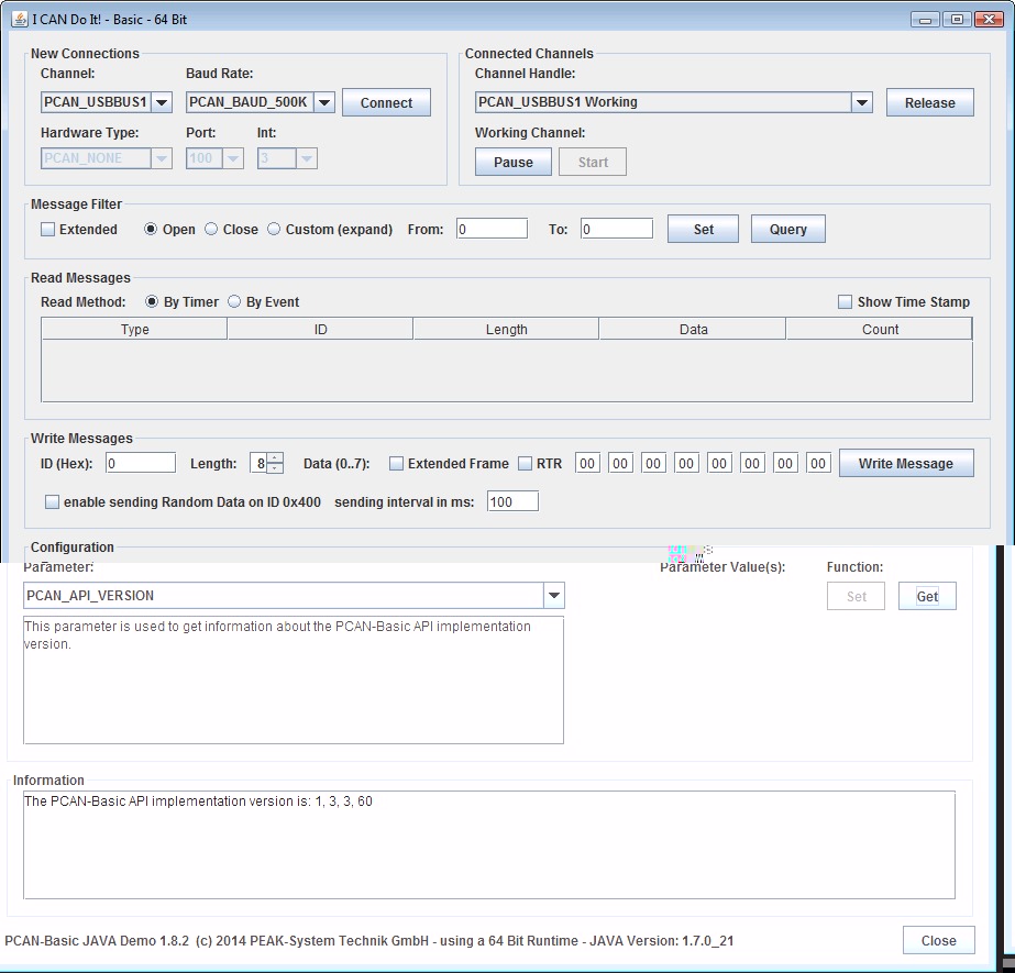

Works fine with Java 1.7_21 RT 32 & 64 Bit
64BitRuntime on W7 64Bit OS

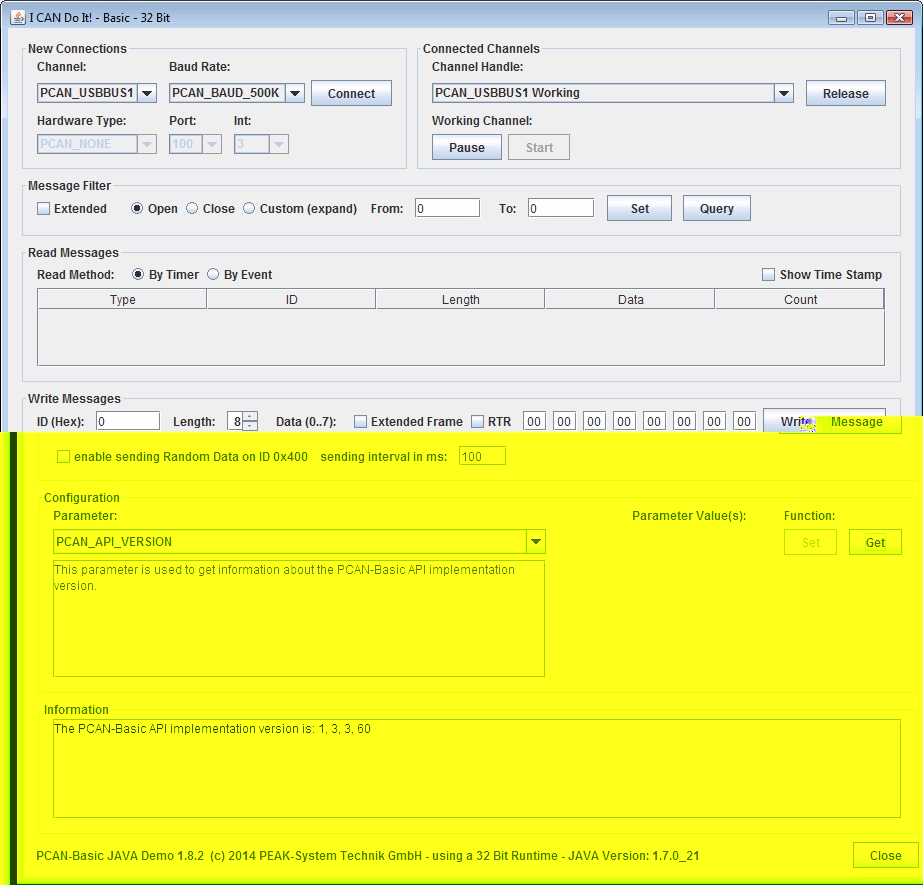

32BitRuntime on W7 64Bit OS
