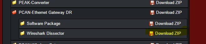

We also offer a wire shark LUA extension so that yopu could "sniff" also the traffic using Wireshark and see how the packate is build. See here: http://www.peak-system.com/produktcd/ You will see the incoming Messages from the CAN Gateway – that’s all – the rest is your own software.

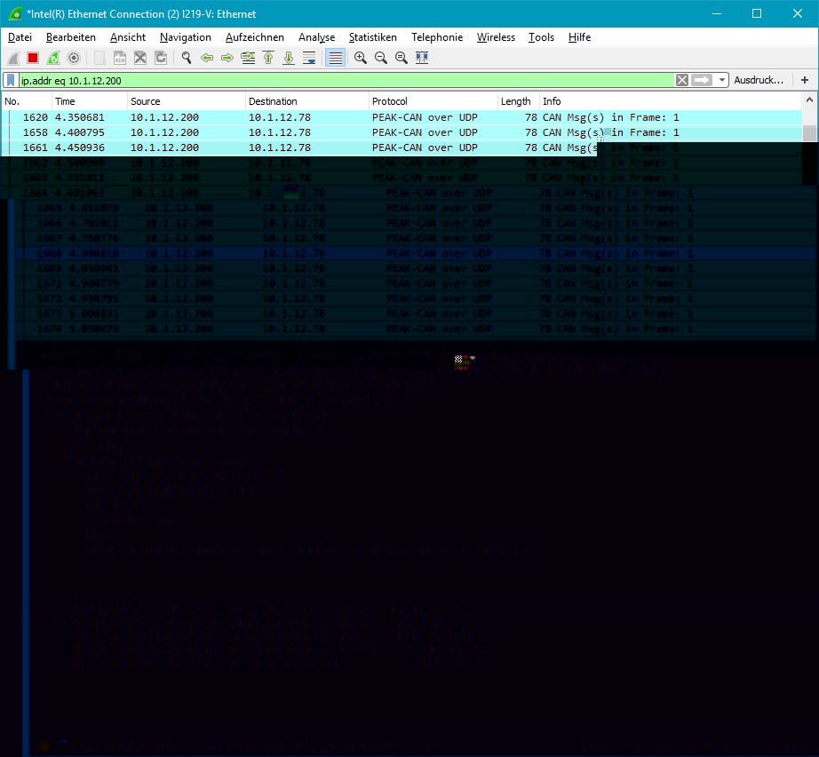

Here you find a screen of a simple incoming UDP Stream on port 52000 to IP 10.1.12.78 in WireShark (using the Injector – but you also could run without)
It must be a problem with your Datatypes you use. For me it looks as you simply print out the Data as ASCII Code...but these are binary Data !
Please check this first:
• Switch Handshake of the used system off
• Define ONE route from CAN1 to IP: xxx.xxx.xxx, set Handshake off, use UDP, port yyy
• Create CAN Traffic on the CAN1
• Open on the target PC with the IP xxx.xxx.xxx. (don’t care if Linux, Windows, iOS, UNIX etc…) your Wireshark Tool. Listen in WireShark on the defined port yyy
