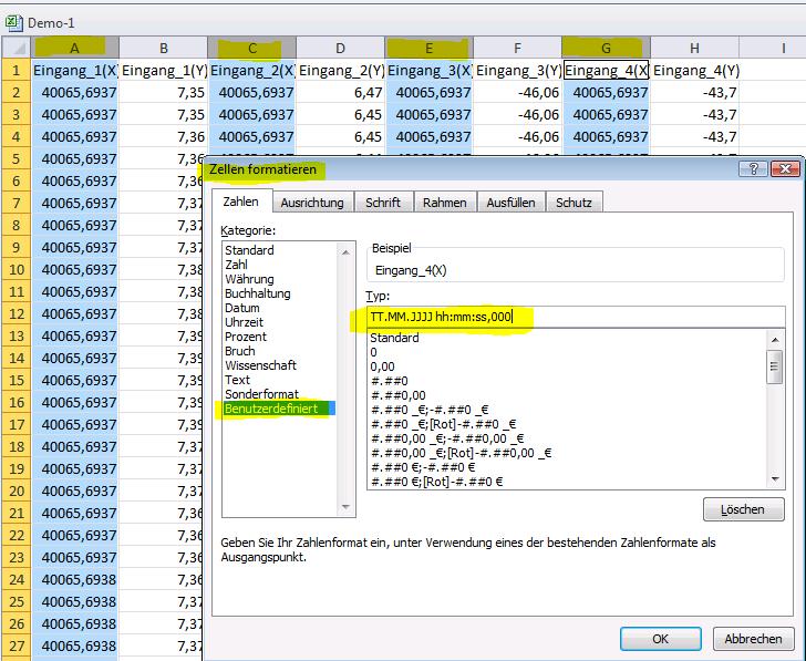

Then you could simply use the information inside Excel. The Time (x) use the Windows format:
The DATE type is implemented using an 8-byte floating-point number. Days are represented by whole number increments starting with 30 December 1899, midnight as time zero. Hour values are expressed as the absolute value of the fractional part of the number.
You need to use a custom format inside Windows Excel: TT.MM.JJJJ hh:mm:ss,000
Excel-Date/Time Format
