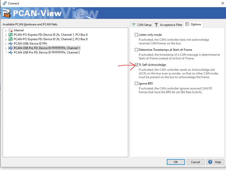

at the moment the presume-ack is not available in the Linux Netdev drivers. But all PCAN FD PC CAN hardware are able to handle the so called "TX-Self-Acknowledge" feature which could be used under Windows with PCAN-View 5.x.
We will discuss this topic with our Linux driver developers, maybe we could implement it in one of the next releases.

Great, thanks Michael! Would love to hear the outcome of that conversation. Sounds like presume-ack and TX-Self-Acknowledge are more or less the same for our use case at least.
Please let me know if there's anything we can do to speed the implementation; I looked for documentation on the CANFD FPGA register set, but it doesn't look like it's publicly available.
