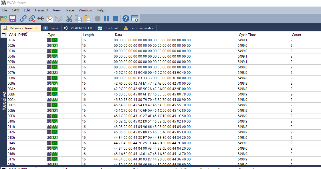

I followed your instructions to initialize PCAN and used CanTpApi.Read_2016, but the return value I got was PCANTP_STATUS_NO_MESSAGE.
As an additional note: I can confirm that the incoming data is being received successfully and is fully visible in PCAN-View. This suggests that the hardware connection, wiring, and baud rate are all configured correctly. However, the API still fails to catch the messages in my application.
Below is my code. Could you please take a look and help me check if I missed any initialization steps, network mappings, or filtering configurations?
