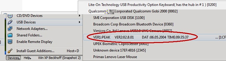

Today I received my PCAN USB device and tried to get it running in this virtualised environment. The installation went well, however the problems started when I tried to mount/attach the PCAN USB device in the virtualised environment:
Mounting the PCAN USB device

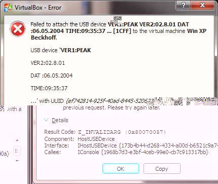

The first time I tried mounting the PCAN USB device nothing seemed to happen. I waited a bit as it normally takes a few seconds for the virtualised environment to see new USB devices. Nothing happened. I then tried mounting the device again and received the following error:
Screenshot of Virtualbox error window when mounting PCAN USB device
I've used Virtualbox long enough to know that when you get these types of messages, the best thing is to just reboot both the guest and host operating systems. I did this twice and still the same thing happens.

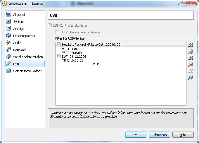

normally the usage of the PCAN-USB adaptor inside a virtual enviroment is not a problem. But it can not be guaranteed by us. It looks that something block the device. In the past i had an similar problem with an AMD-PC (AMD Phenom processor + AMD chipset @ Win7 64 host + Win XP guest). The problem was the "AMD usb filter driver" (for audio devices and so on). After uninstalling the "AMD usb filter driver" everythings work as expected. Maybe it´s a similar problem with your Intel powered PC. Sometimes it helps to create an empty USB filter.

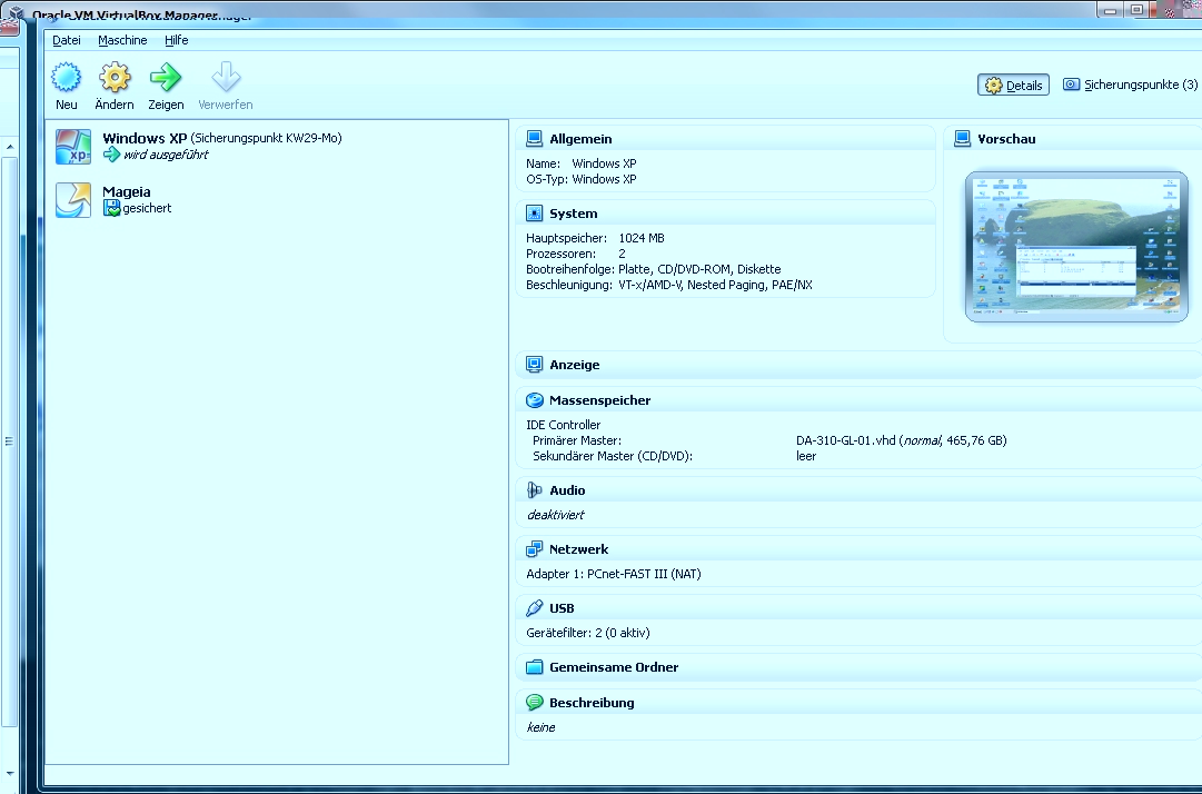

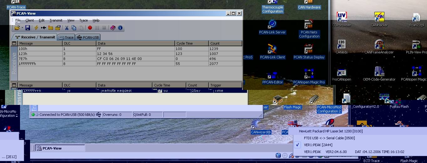

Hi ,

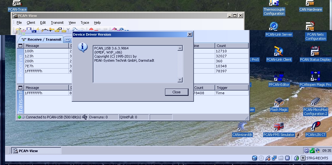

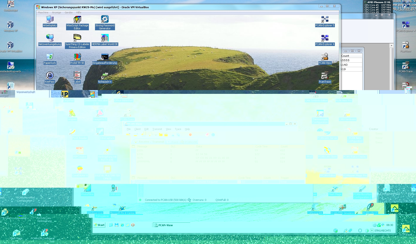

there´s a PCAN-USB adaptor running @Win XP 32bit under a Win 7 64bit host on my desk.
here are some details:
host: Windows 7 64bit
guest: Windows XP 32bit
CPU: AMD Phenom X6
VirtualBox version: 4.1.18
VirtualBox extension pack : 4.1.18
VirtualBox USB-2.0-Controller: not active
PCAN-USB driver version: pcan_usb.sys version 3.6.3.9864 (out of date)
AMD usb filter driver: not installed
But note: we cannot guarantee the proper function
Win XP with working PCAN-USB adaptor
PCAN-USB adaptor at Win XP
VirtualBox overview
VirtualBox overview
VirtualBox USB-controller settings
used pcan-usb driver version (outdated version, please use allways the current version)

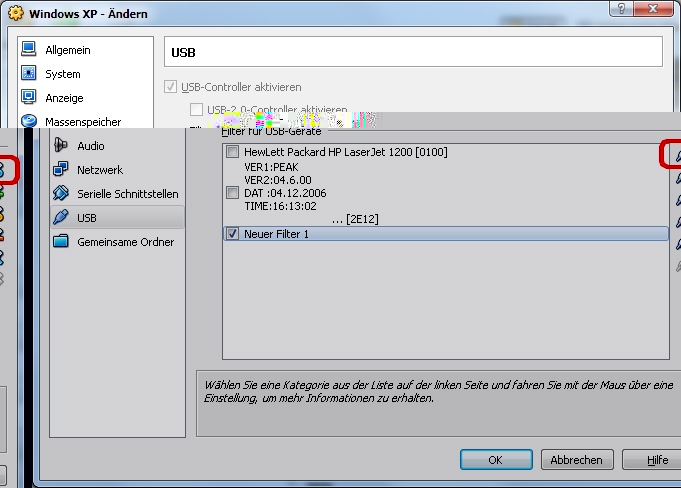

Found this solution on Mac thread, worked fine for me:
1) "Add filter from device"
2) Edit the filter entry and clear everything except the "Name:" field.
3) Reboot and connect the device (evtl. also reboot the host).

The method recommended by neuweiler (remove everything but the Name field in the filter for the PEAK device) *almost* worked for me, except that the next time I closed and restarted the VM, it captured *all* of my USB devices, including a USB mouse and keyboard, which was not at all desirable.
What *did* finally work for me was removing only the information from the "Product" field, as recommended in a comment on the VirtualBox forums: https://www.virtualbox.org/ticket/10309#comment:5
