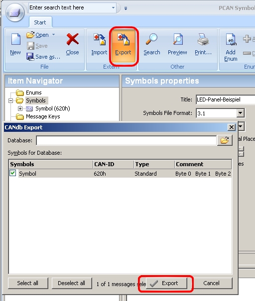

Post by M!chae! » Fri 12. Nov 2010, 16:37
Is there a conversion from PEAK .sym file to .dbc file or can a sym file be exported as dbc file?
Thanks for help!
Posts: 174
Re: Convert .sym to .dbc
Post by G.Lang » Mon 15. Nov 2010, 09:47
Hi Michael,
you can export a *.sym file to a *.dbc file via the PCAN Symbol Editor if the CANdb-Import is licenced with your PCAN-Explorer 5.
