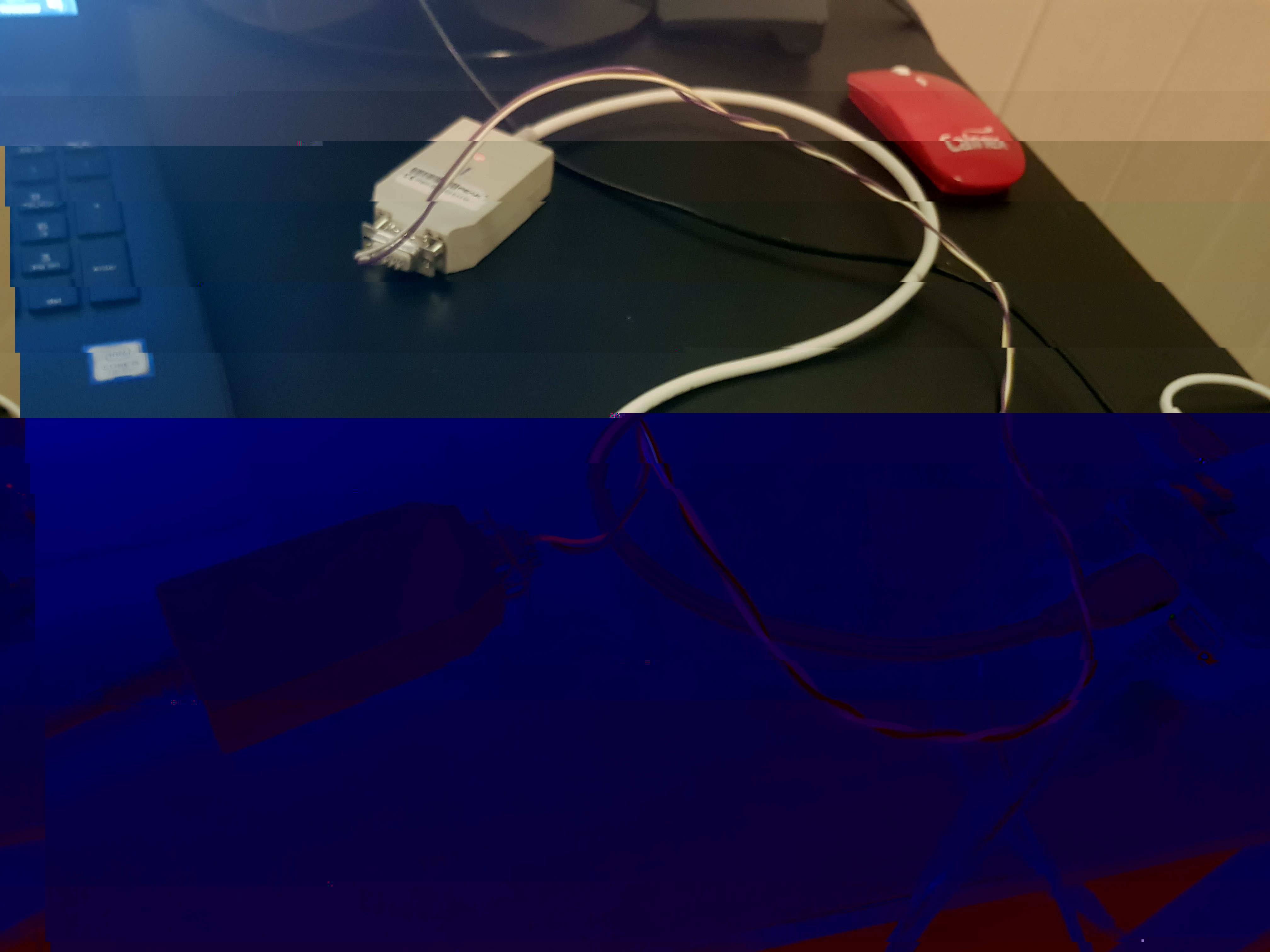

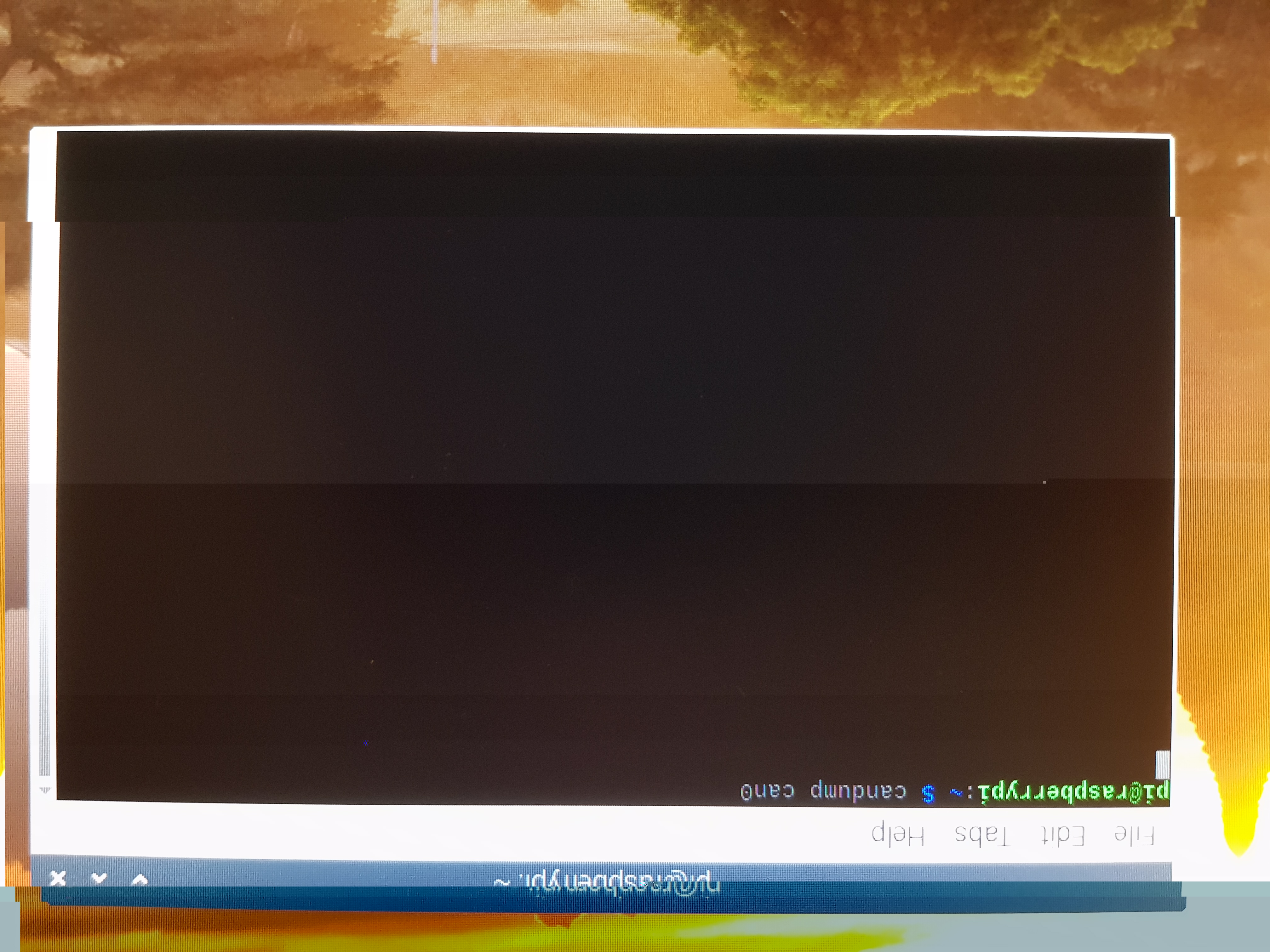

When I do candump can0, the screen freezes and I can't do anything. I have posted a picture of my setup below. One port of PCAN USB is connected to Raspberry Pi and another port( I am using two PCAN USB's) is connected to my laptop(windows) and I am trying to send the data from laptop to the raspberry pi.

Re: Sending real time data from PCAN USB to Raspberry pi4
please check your CAN cables for 120Ohms termination resistors on both ends. Next, please send a screenshot of the Windows PCAN-View showing the frames you are transmitting and the status bar. Please also post the ip link command you have used to configure can0 on your pi.
BTW: in a linux console it is not a freezing, it is just working, but as long as there are no frames you will see nothing
. Use CTRL-C to break candump again

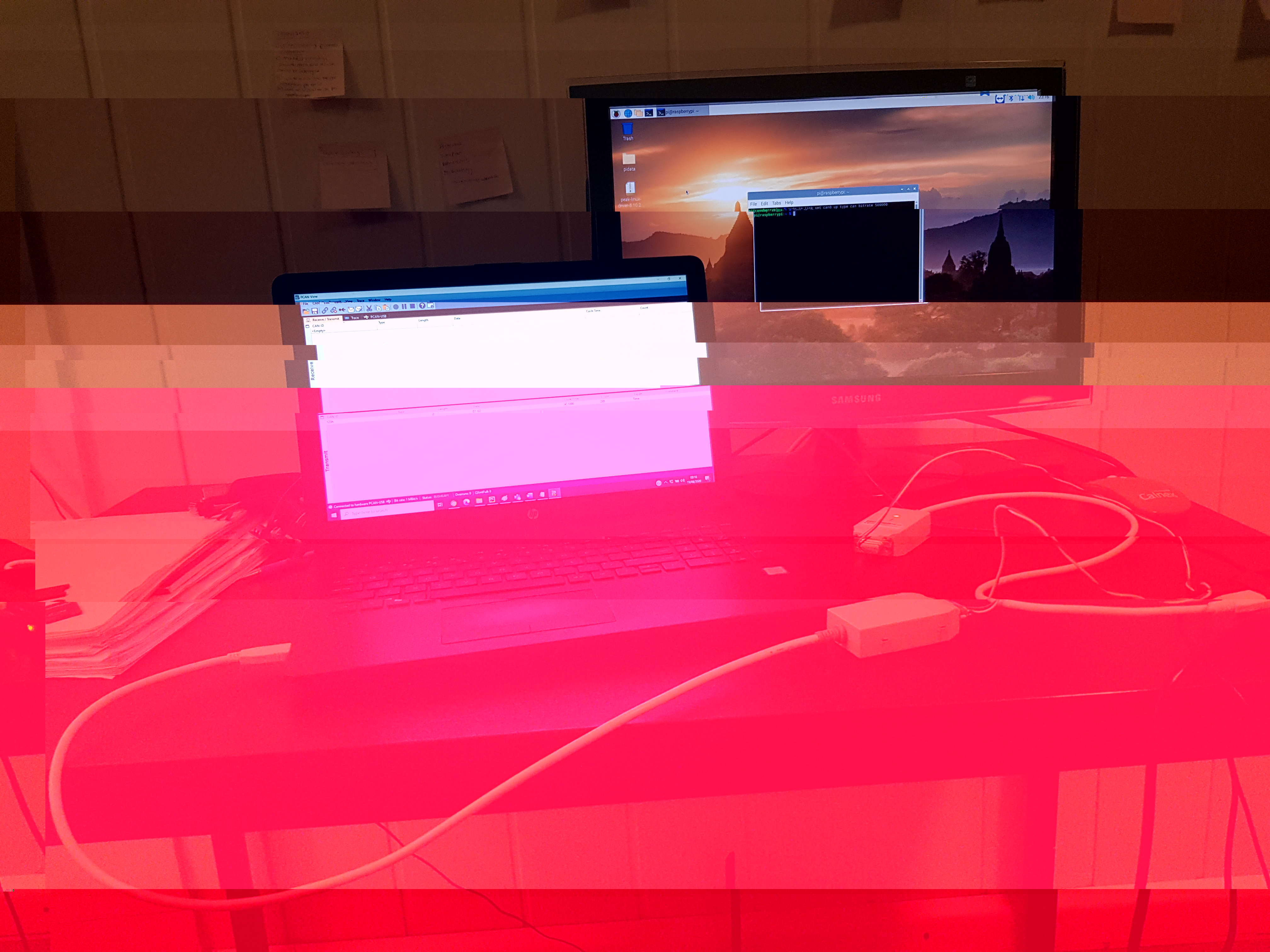

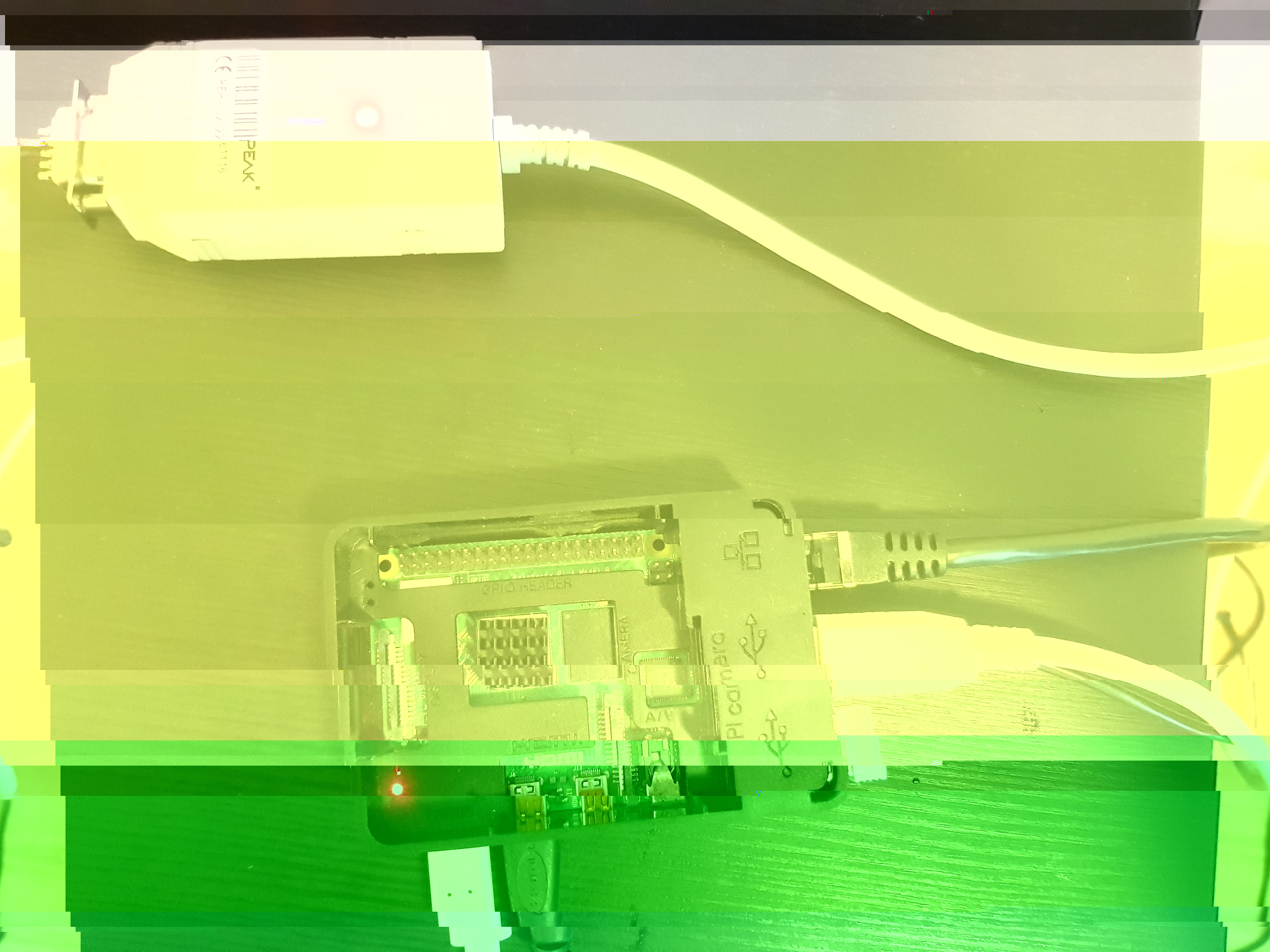

Please find below attached the screenshots of my setup.
I have checked the termination resistors. The status bar of PCAN shows 'OK' and unable to receive any messages at the terminal of RPi. Also, when I do candump can0, I cannot stop the process using CTRL+C. The Rpi just stops working and I have to start again by unplugging and plugging the power. Need you assistance in this regard.
as I can see on those pictures you are using 1MBit/s under Windows, while you have configured your PI to 500k....please use the same baudrate on both systems to be able to communicate.
Please also post the output of cat /proc/pcan again after your test
