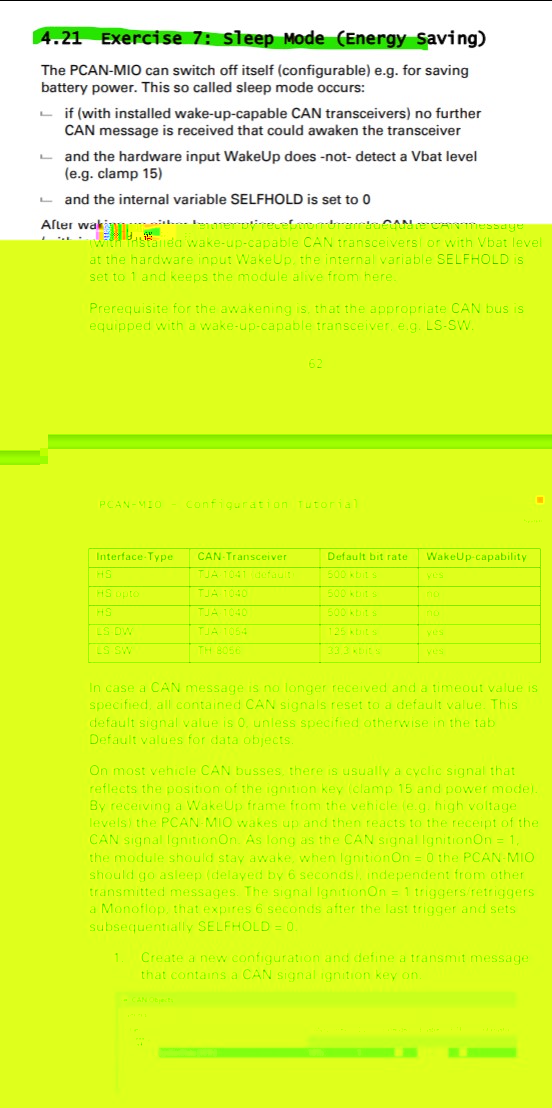

is it possible to set the PCAN-Router Pro to sleep after a certain period of time (5 seconds) when no more messages are recived?

Hi Joel,
please take a look at exercise 7 at page 62 inside the "PPCAN-Editor configuration tutorial for PCAN-MIO", this exercise will also work for the PCAN-Router Pro.
