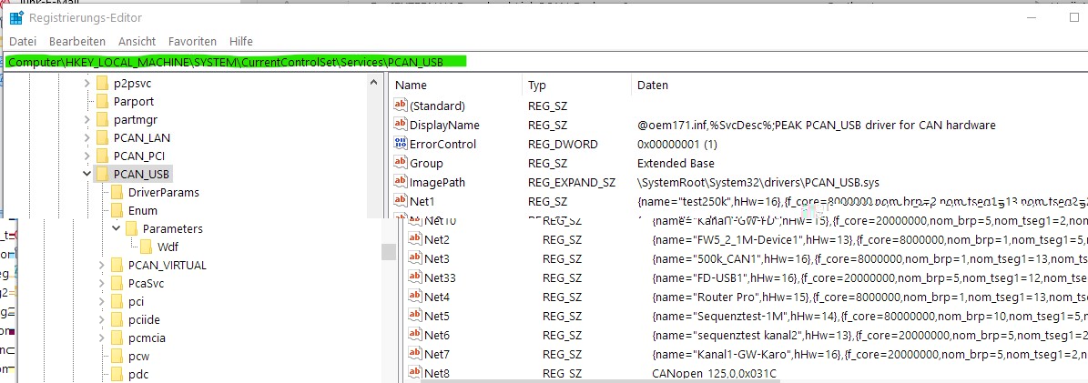

please close all PEAK software and make a screenshot of the [Computer\HKEY_LOCAL_MACHINE\SYSTEM\CurrentControlSet\Services\PCAN_USB] branch and post it here

CanGuru
Re: PCANView Bug at program start
Post by CanGuru » Fri 27. Jan 2023, 11:14
Hi Mr. Lang.
Thanks for your help.
Here is the screenshot:
i have to use the redistribution driver from our customer, so it would be nice if the can-network and driver could continue to be used
(because I don't know whether the customer programs will still work with a new driver.)
The bug is independent from the customer-program, which is using a can-network (after starting the pc, no customer-programms are executed, no services are running!).
Posts: 174
Post by G.Lang » Fri 27. Jan 2023, 12:40
you have a defined a fixed net called "PCANLight_USB_12" with a baudrate of 125k (BTR0/BTR1 value 0x031C) in the registry and therefore, if you start the PCAN-View with 250KBit/s you get the "wrong" baudrate.
Solution: Delete all nets with "PCANLight_xyz_xy" nets in the registry.
Such a fixed net will definitely not be created by the PCAN-View or PCANBasic API, such a fixed net can only be created manually or via a very old PCAN-Developer suite (or from the redistributable package of the PCAN-Developer suite). Newer PCAN-Developer suites don´t allow to create "PCANLight_xyz_xy" nets. The net names "PCANLight_yxz_yx" are reserved nets for usage with the PCANView/PCANBasic API and don´t be fixed/stored in the registry.
The next PCAN-View release version will delete such "PCANLight_xyx_xy" nets to avoid such issues.
