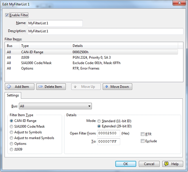

The PCAN-Explorer 4 & 5 could open differnet filter types, like CAN From - To (Std and Ext. ID), Message Types, CAN Controlelr Code/Mask filter, Symbols and PGN (if the J1939 AddIn is available)
Filter Options in PCAN-Explorer 5
