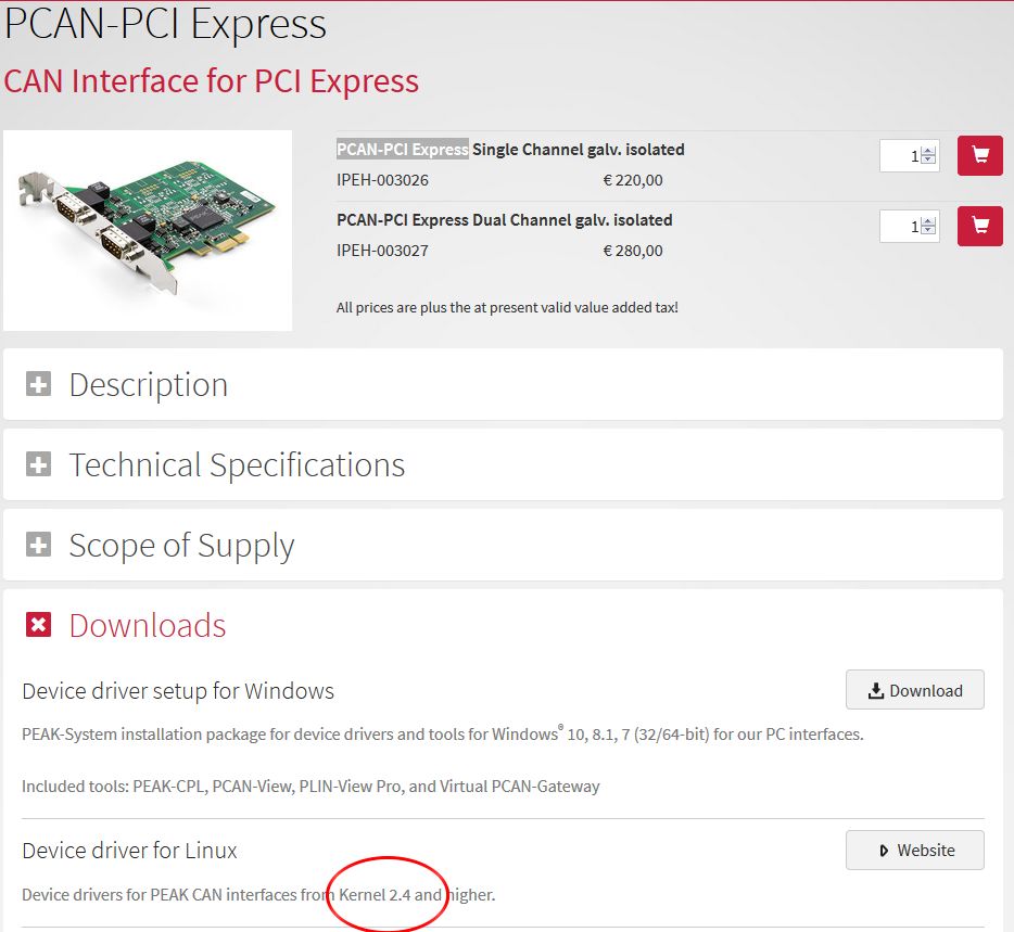

We are bought this card because the written support of kernel 2.4.
It's so sadly for us.
