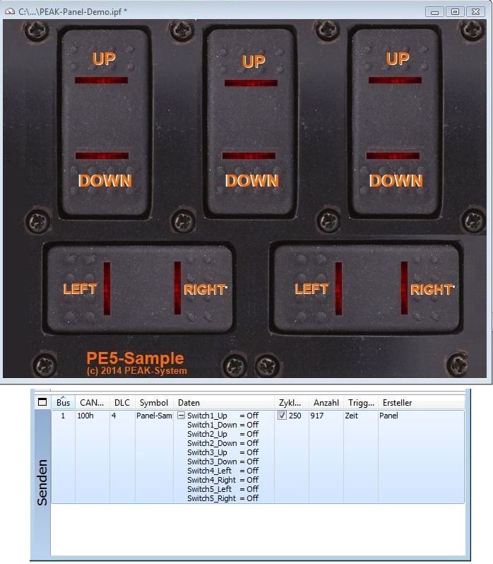

Please find attached a PEAK-Panel Sample which use single Bit of a Databyte for every switch.
- Bitmap of running Panel and datastructure in Send Window
- Panel-Demo.JPG (133.14 KiB) Viewed 9542 times

Good Morning,
Thank you very much for the example posted. I've played with it a bit and it seems to work quite well. I noted that it had been viewed and downloaded twice, before I did, so am thinking it will definitely help others learn how to better use the Peak tools. I need to study the properties of the buttons yet, so as to understand why these work, and those I implemented on my panel didn't. That's my task....
You folks have a great product. I think the best way to grow your userbase is to continue in this same manner, helping users resolve issues, while expanding their knowledge in how to best use these tools.
