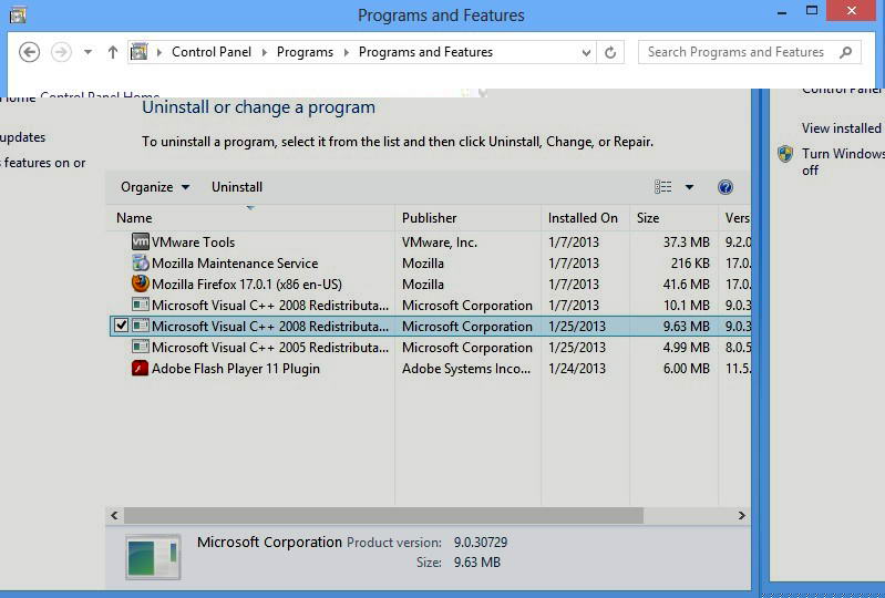

this can have several causes:
  • The dll has get corrupted.
  • The uninstall of an application has removed the dll.
  • You don't have installed the C++ Redistributable (2008)
The only case in which we can help you is the last one. Check if you have installed the C++ redistributable in your system. For this, check the "Programs and Features" list of your Windows. For example:
Windows Intalled Programs
If you don't have such an entry in your list, then you have to install the redistributable pakage. According with the plattform you are using you will need to install one or two packages, one for 32-Bit and another for 64-Bit. Here are the links for those packages:

Post by Charlie » Mon 11. May 2015, 13:42
Hello Keneth,
Thanks a lot
The C++ Redistributable (2008) is already installed (cf screenshot)
I've downloaded mfc71.dll from this site (http://python.net/crew/skippy/win32/)
& added it to C:\Windows\SysWOW64 : the demos work fine :)
