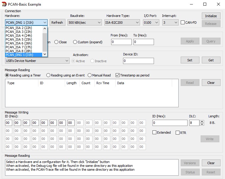

- Posts: 5
- Joined: Mon 16. Nov 2015, 06:31
Re: Unable to find the library PCANBasic.dll
I have attached the snapshot of application where no option in the dropdown list as 'PCAN_PCIBUS1 0x41' as handle for channel1.
I have developed vb application with other CAN hardware but as now with current requirement i want to use that application with this current hardware i mentioned in previous message.
so i have to change the communication level interface of that application , so that it will work with the PCAN PCI-e card as well.
i want to check that how this PCAN Basic sample example works.
I want to send and receive CAN messages with this PCAN Basic sample application so that i can implement the similar changes in my current application code.
Regards,
Sagar
Regards,
Sagar
- PCAN Basic sample screenshot
- PCAN basic.bmp (1.95 MiB) Viewed 23336 times
is the PCAN-PCI card correctly installed on your system? Do you have any other software running which uses that card at the moment. Does PCAN-View show the card?

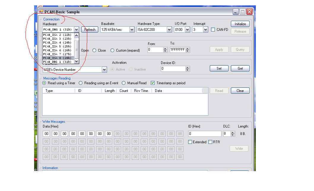

Hi
I am using the PCAN-USB Pro hardware, and when running the PCAN-Basic Example I'm getting a similar problem.
1. When I run the application, a compile error in line 990 appears and it does not compile.
2. I commented lines 989 to 991, and now I am able to compile.
3. After compiling, I get an error message “Unable to find the DLL PCANBasic.dll!”
4. Once the application is open, I can not find the PCAN_USBBUS1 hardware.
How did you solved this issue?
