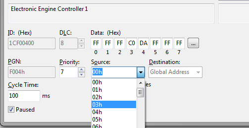

I am able to open the "edit message" window, but I am unable to edit the ID, only the data (notice the message ID and DLC are grayed out):

I just now realized I can do what I need by adjusting the "priority" and "source" values, and the ID updates as desired, while maintaining the appropriate PGN:

Yes. When you create a message, you select a PGN, that is, that PGN is tied to that message. The ID is given by the protocol (J1939). This is, it is formed using PGN, Source and Destination address, and Priority. Depending on the kind of PGN you will be able or not to change the destination address and length (DLC).
