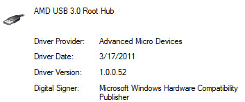

I'm unable to install the PCAN USB Pro FD device. The latest installation package from your website runs just fine and completes but when plugging in the device the driver install fails. The driver package also breaks the USB on my PC Motherboard. I have to select an older driver in Device Manager to get my PC USB working again.

- Current Working USB Host Controller Driver
- WorkingUsbDriver2.jpg (20.44 KiB) Viewed 14471 times
- Current Working USB Root Hub Driver
- WorkingUsbDriver.jpg (19.83 KiB) Viewed 14471 times

Never heard about an issue that an installation of a PCAN-USB-Pro FD breaks an USB driver. Using a chipset driver for USB3.0 from 2001 could cause other problems, so try to update your USB chipset driver again to a newer version. There are known problems with USB3 drivers from 2011:
http://www.peak-system.com/forum/viewto ... ?f=7&t=191

I updated the USB drivers to current. My USB still breaks after running the Peak Installation and rebooting and the PCAN USB Pro device will still not start.
- DriverDetails.jpg (158.23 KiB) Viewed 14450 times
- DeviceStatus.jpg (49.74 KiB) Viewed 14450 times
