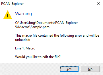

When I attempt to run a macro now, I often encounter an error similar to the following:
Macro Error on instantiating PCAN3.PCANClient object
This started happening after I set up PCAN Explorer 5 on my new Windows 10 machine. It was never an issue when I was running Windows 7. I'm not sure if that's a factor, but thought I'd mention it.
I've isolated the error to the inclusion of the CreateObject() call that instantiates the object:
  Dim MyClient
  Set MyClient = CreateObject("PCAN3.PCANClient")
The error isn't very descriptive so I'm not sure why it's tripping on this.
In VB (but not VBA), I could instantiate the object using early binding (e.g. Dim MyClient As New PCAN3.PCANClient) but this does not work in VBA, both of which I'm quite rusty at!
Any insights would be greatly appreciated!

which PCAN-Explorer 5 version do you use?

I was running PCAN Explorer 5.3.2.808, but as soon as you asked me the question, I downloaded/installed 5.4.2.902. I haven't rebooted my Win10 machine yet, but simply installing 5.4.2.902 has allowed me to run my old macros without problem now, including the CreateObject("PCAN3.PCANClient") call.
Odd, since I didn't need to upgrade PCAN Explorer on my Win7 machine. But, problem solved!

Thank you for that feedback - looks like a lack of authorization with the older Explorer and the latest Windows 10 Uptades.
