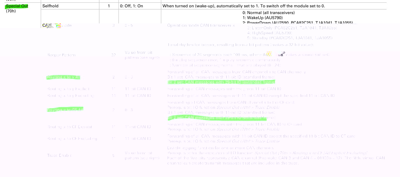

if you want to forward all 29bit messages then you can use the "Routing x to y All" command (with value 2 -> bit 2 is set)
If you want to forward only some 29bit IDs then this can be realized via "4.7 Exercise 3b: Translating a CAN ID" and "4.8 Exercise 3c: (Variation 3b)Transmission Only if Source Message was Received" from the PCAN-Router Pro tutorial.
Please note:
-> The amount of "Receive messages" is limited to 120
-> The amount of "Transmit Messages" is limited to 350
-> The amount of "Gateway Messages" is limited to 120
