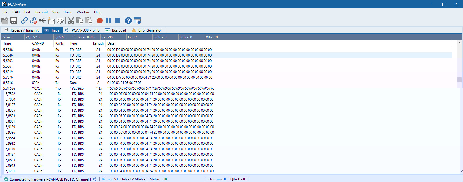

Good day! I have the same problem with displaying the time. Why does it always start with 429496 ?

Restarting the computer does not help! In the date and time settings, I turned off the automatic update of the time zone, after which the time began to work correctly, but after that in the trace window it sees only its own data, but it does not see external data in the receive window!

Returned all computer settings to their original position, but the program has not changed, the time is displayed correctly. In trace mode, the external signal (X) starts with a delay of 15 seconds. If you exit the PCAN-view program and reload it, then the external signal (RX) does not work at all! you have to reload the driver.
