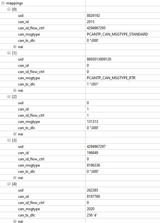

I get the response, but UDS_WaitForServiceWithReadDID() prints ""An error occurred while sending the request:" and returns error code "SERVICE TX ERROR", eventhough I get the response from the ECU (as seen on screenshot below).
Screenshot 2021-05-05 162903.jpg (18.71 KiB) Viewed 3819 times
I am guessing I messed up with mappings, but I can't find where I went wrong. :oops:

I agree, my code is different than one that PEAK provides in PCAN-UDS-API_UserMan_eng.pdf file. It's because when I was debugging, I noticed mappings array was strange, and I got error code back for a lot of mappings in the array. For instance, UDS_RemoveMapping_2013() call for mappings[1] returned with "PCANTP mapping parameters are invalid" error code text. On the screenshot below you can see debug information for the array.
Screenshot 2021-05-05 162903.jpg (74.37 KiB) Viewed 3803 times
Although I suppose I can use your code and not theck the returned uds_status and always return PUDS_STATUS_OK.

I replaced my code with yours and now I get error code text SERVICE TIMEOUT RESPONSE, so we're going somewhere. :)
I debugged to line
printf("An error occurred: %s\n", str_msg);
and checked variable 'request.msg.msgdata.any->netstatus', which's value is PCANTP_NETSTATUS_OK. I don't understand what you mean by "it is initialized by UDS_SvcReadDataByIdentifier_2013", could you explain it on a simpler level?

I noticed that my mapping2 is replacing the first mapping. I printed "can_id - can_id_flow_ctrl" for whole array from getMappings() and got this:
28b - 30b <- this one i added, but "30b - 28b" is missing
0 - 8

F.Vergnaud
Posts: 305
Joined: Mon 9. Sep 2013, 12:21
Re: SERVICE TX ERROR
Post by F.Vergnaud » Thu 6. May 2021, 14:57
In fact there is something wrong with the mapping list you are outputting... Starting from mappings[1] data seems corrupted.
It seems to be a problem with mingw, I'll let you know if I can confirm this.
Fabrice

Post by ValeV » Thu 6. May 2021, 16:11
I found the error. In PCAN-ISO-TP_2016.h file I had "#include <stdint.h>" commented out, because my company uses their own header file of typedefs compatible with MISRA C guidelines. Problem was I included the wrong such header file, so everything was messed up. I included correct header file now and so far everything works fine.
Thank you for your help, I still improved the code thanks to you.
