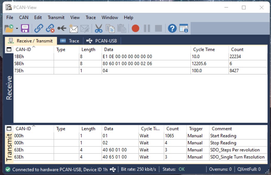

I was just looking for a simple software tool to just check if a CANopen sensor is working good. I know there are lots of dedicated tools that use the PeakCan USB adaptor to do this. I then decided to use the PeakCAN View itself for this !! Its so handy for the purpose and you can store a set of CAN Open commands and check out the interface. I know this must be basic for regular users but new for me !!
Attaching a sample interface which I did for a Hengstler Encoder. :)

OK - there are free to use CANopen basic Tools available - see link we already send - but you also could use basic tools ig you know how to do...
also in this topic you find thw basic to get a CANOpen network to run with PCAN-View --> LINK
