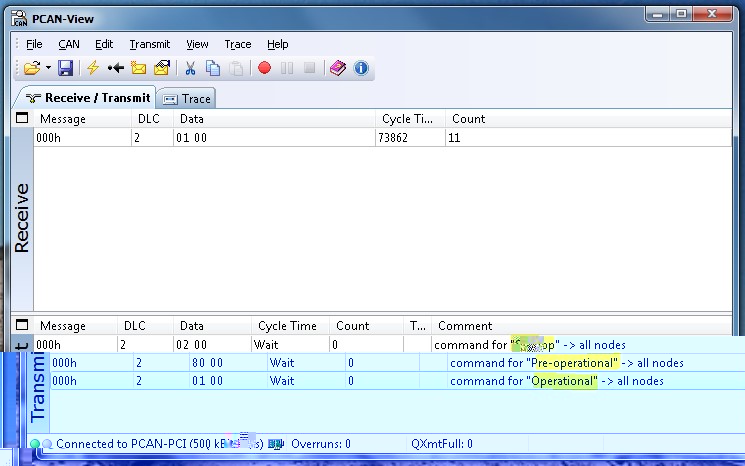

A very easy way to set a CANOpen Network in different modes:
- Stop
- Pre-Operational
- Operational
PCAN-View
PCAN-View
Simply load the Transmit List into your PCAN-View. More Info about CANOpen(c) could be found on the WEB.
[Thanks to G.L. for the xmt file]
op_preop-stop-command.xmt
XMT File with comments for CANOpen Basic Commands
