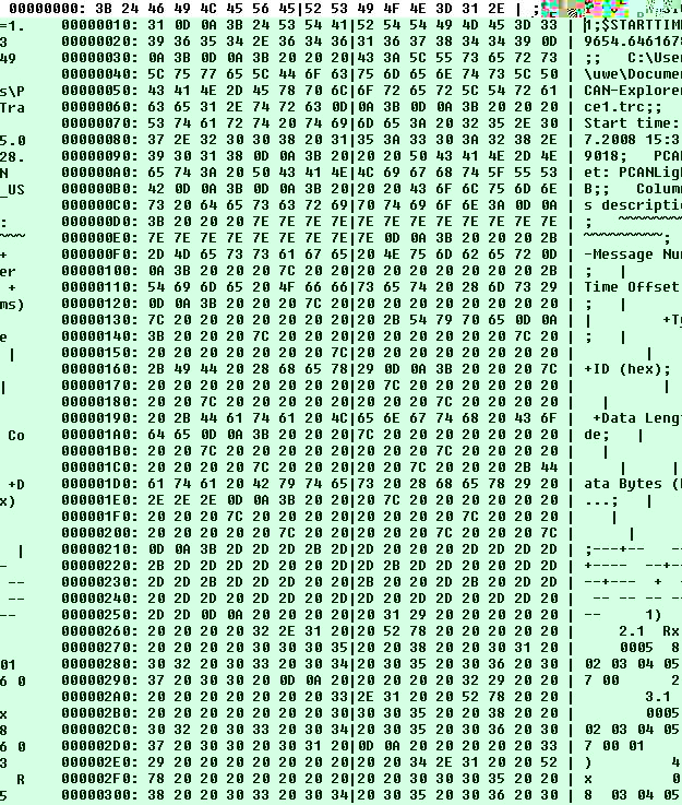

The Trace file is a ASCII Textfile (8Bit character - no unicode).
The Linebreak is a CR (0x0D) and a LF (0x0A)
We do not use Tab - only Space (0x20)
Trace File  - view in HEX Editor
