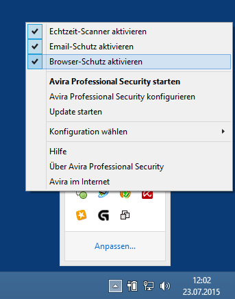

Via the tray icon of Avira (at the bottom on the right in the task bar) you can deactivate this function. It will be restarted with the next reboot or if you switch it on manually. Here a screenshot of a German version on Windows 8.1.
