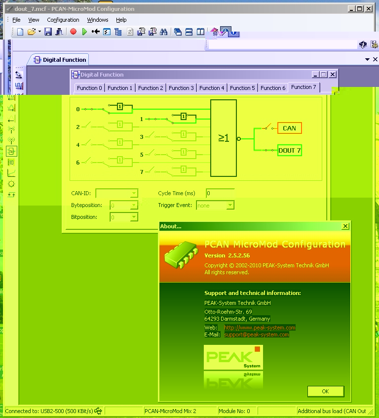

Possible bug/future feature?
Dout7 is not available within the Digital Function setup, only Dout 0.

Dear Matt,
strange, i my version 2.5.2.56 of the MicroMod configuration 2 software the Dout7 is available in the "Digital Function" window. Please take a look at the screenshot below:
When you set Din0 or Din1 to GND the LED goes on. Please send me your configuration file (*.mcf) to support@peak-system.com

That is odd,
Mine definitely only has CAN and Dout0 available. Why does your only have CAN and Dout7, where is Dout0?

Post by G.Lang » Thu 30. Sep 2010, 09:21
that is not odd -> this is the difference between the tab "Function 0" and tab "Function 7". Please switch to the "Function 7" tab and you can also configure Dout7.

Ahh I see,
I assumed that each function had access to all available digital outputs, and had not spotted you had a different tab selected. :oops: .
