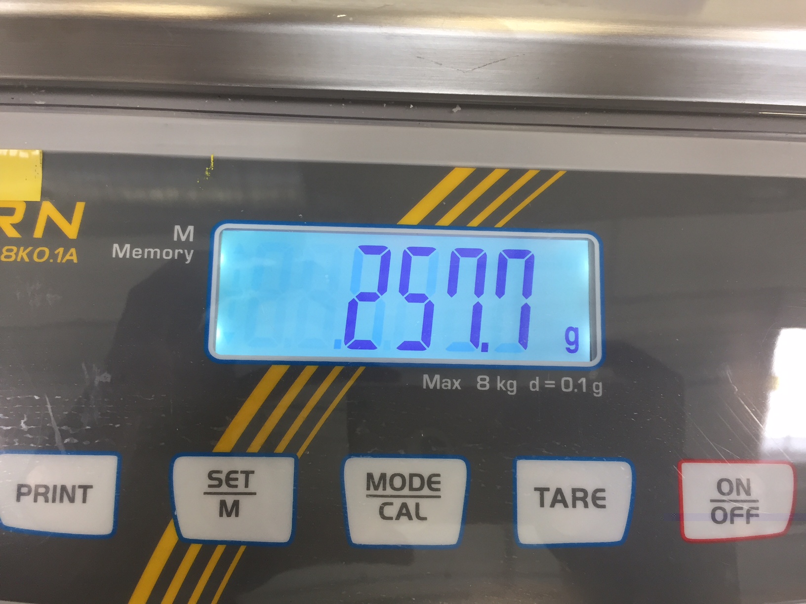

I have to develop a software to control an balance using PCAN RS232. The balance can be remotely control by using ASCI character in my software. And after the balance having the commands , it will send the weigh as ASCI data, as can see in the picture.
I use PCAN view and then CANape to view the data after transforming the ASCI data. But the problem is the number sent by the balance is float and I don't how to transmit/receive that number in CAN trame and then display it in PCAN view and CANape.
NB: PCAN view version 4.1.1.463
OS Windows 7
In the table, B means Blank.

weigh of object
weigh of object
ASCI character sent by the balance (18 bytes)
