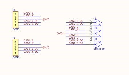

The SUB-D plug was modified to match the test setup i use and it looks like this: So 2 CAN lines end up on one SUB-D Plug with a common GND (to my knowledge the standard is that that each CAN line has a seperate SUB-D plug).
