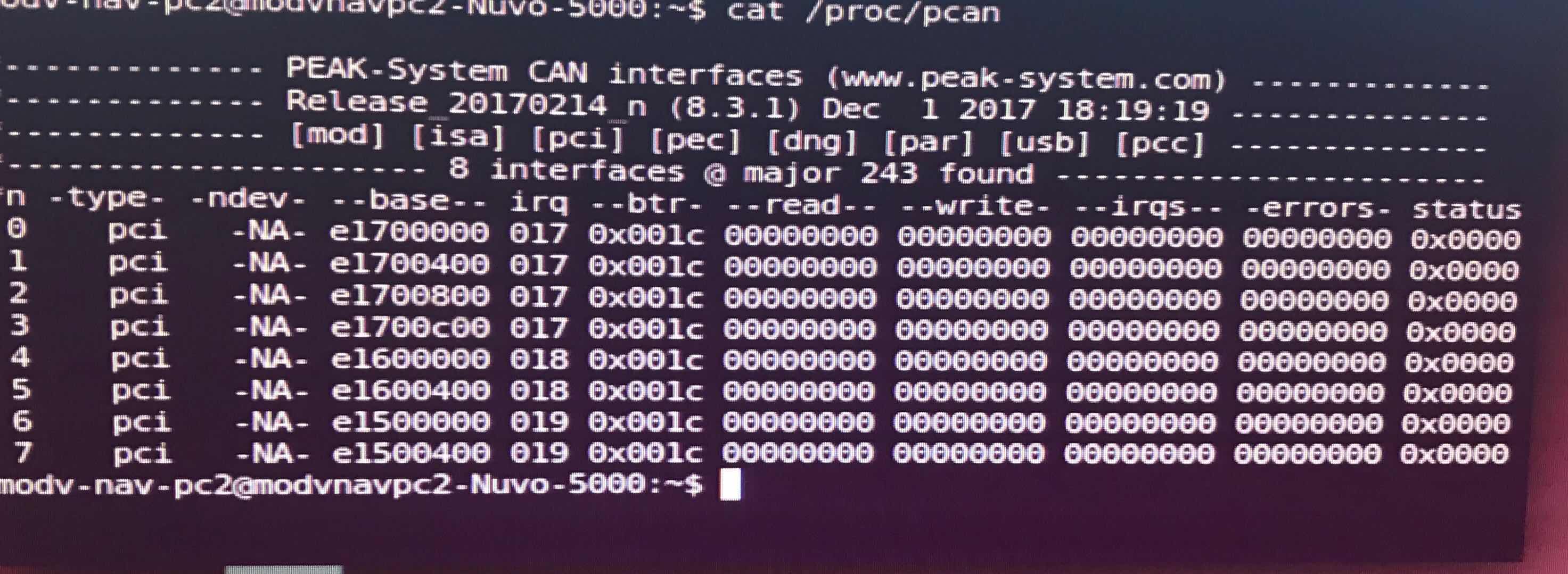

Now I use 4 PCAN-miniPCIe in one PC.
I cant know which connector is the PCAN0.
I found sometimes the serial name will be changed when I restart the PC.
How can I know which one is the PCAN0? How can I fix its serial name?
Thank you very much for your help.

do you use the kernel driver for SocketCAN or the peak-linux-driver? If you use the peak driver, please post the output of cat /proc/pcan.

I am using the peak driver.
In this PC, I installed a 4 Channels PCAN-PCIe and 2PCAN-miniPCIe.
In the First Picture, I cant read 4 Channels PCN-PCIe.
[img]/home/common/Desktop/1802144505.jpg[/img]

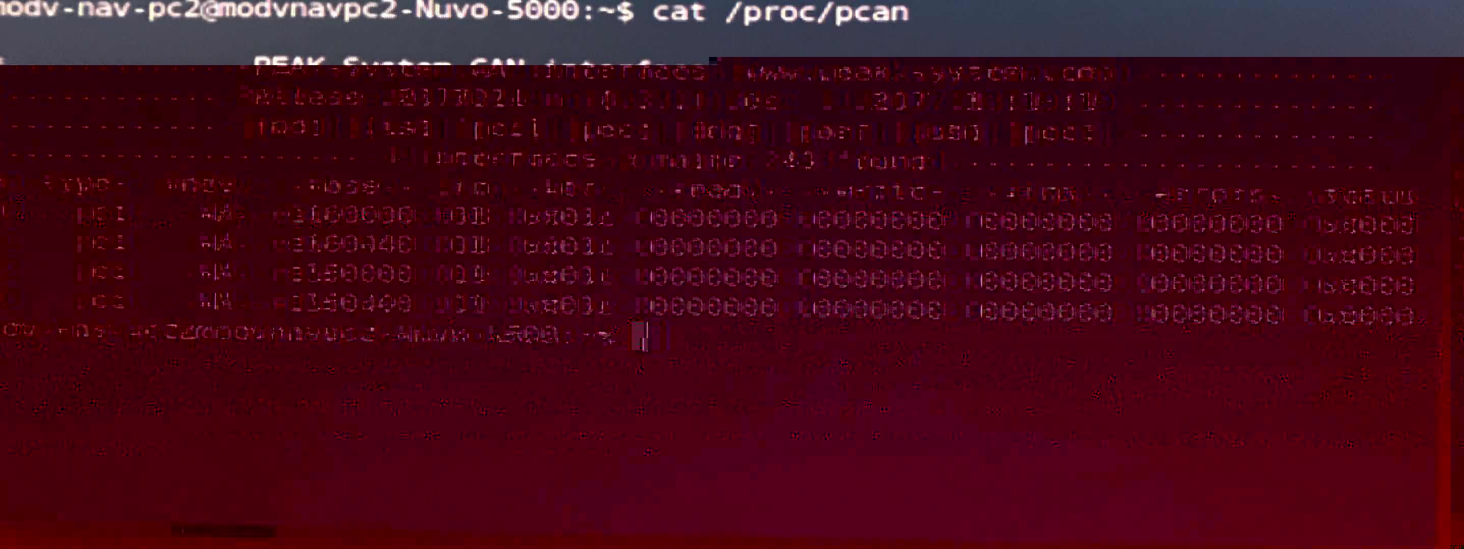

The Second Picture is after I restart PC.
[img]/home/common/Desktop/54302421.jpg[/img]

Post by M.Maidhof » Fri 23. Feb 2018, 09:52
as a first step, please update to driver 8.5.1
